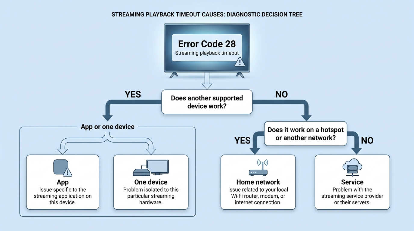

Service, Network, or Device?
I recommend comparing devices before changing settings because a working second device helps narrow down the failure. If the same title works on a phone or another streamer, the account and service are probably reachable; focus on the failing TV, player, or app instead of assuming registry corruption or malware.
| Scenario | Symptom Pattern | Most Likely Branch | First Action | When to Escalate |
| All devices fail across networks | Same failure on separate connections | Service or account issue | Check service notices; retry another connection | Contact support if cross-network failures persist |
| Only one TV or player fails | Other devices stream normally | App, software, or ended support | Restart app; check device support | Use supported streamer or casting if support ended |
| All devices fail at home | Account works on another network | Router, ISP, VPN, filtering, or DNS | Power-cycle router; turn off VPN or proxy | Ask ISP to investigate persistent home-network failures |
| App opens but times out | Slow menus or failed playback requests | App data, software, or connection | Update, force-stop; clear app data if needed | Reinstall if app recovery fails |
| Older device may lack support | App remains; sign-in or playback fails | Device compatibility | Compare exact model with supported-device list | Switch to supported streamer or casting device |
A one-device failure points toward compatibility or app recovery, while an all-device failure points toward the service or network. If all devices fail only at home, investigate the router or ISP; if they fail across networks, contact Fandango at Home.

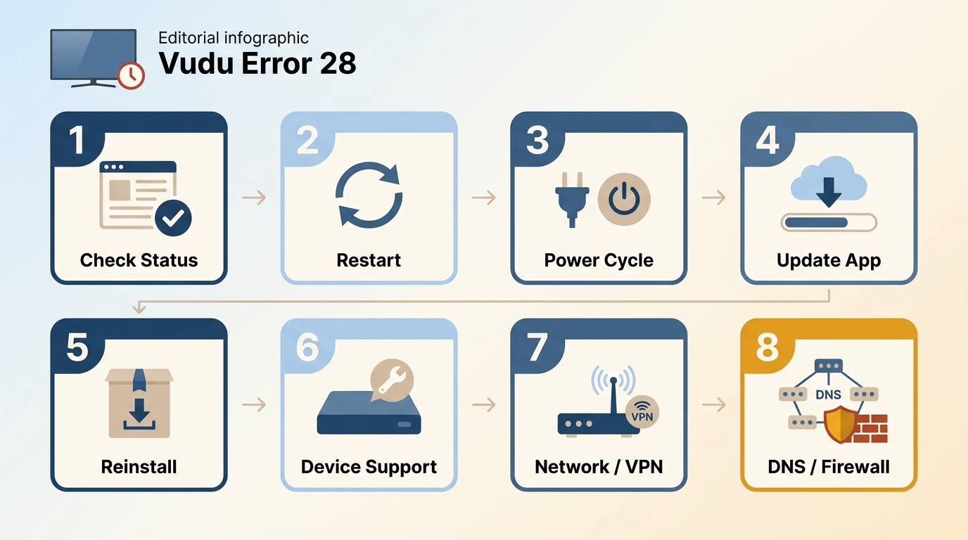

8 Fixes for Vudu Error Code 28
Start with the device comparison, retest after each relevant fix, and stop when playback works. I recommend leaving DNS and firewall changes until app and network checks point to a connection problem; follow the branch skips below instead of completing all eight fixes.

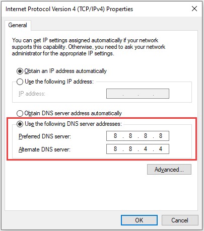

For a reversible DNS test on Windows or a router, Google Public DNS uses 8.8.8.8 as the preferred IPv4 address and 8.8.4.4 as the alternate. Save the current addresses before replacing them.

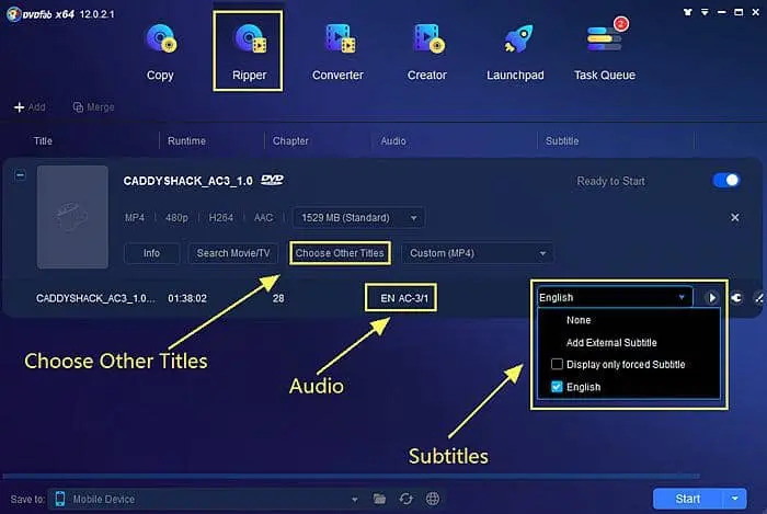

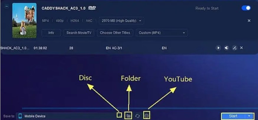

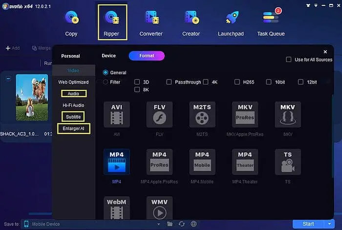

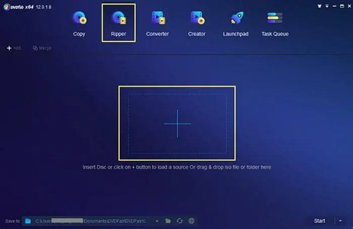

Create a Local Copy in Three Steps
Load the DVD, choose a compatible output profile and the audio and subtitle tracks you need, and save the file to local storage. Once saved, the local file can be played offline on a compatible device. Performance and output size depend on your selected profile and system.

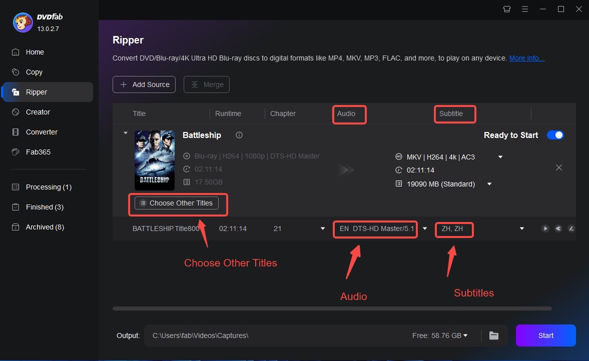

- Load the DVD. Install the Windows or Mac version, open the Ripper module, and insert a personally owned DVD or load its DVD folder or ISO source.
- Choose the output and tracks. Select MP4 for broad device compatibility or MKV when retaining multiple tracks is more important, then choose the needed audio and subtitles.
- Choose local storage and start. Confirm the destination folder, review the profile, and begin the task. Test the finished file on the device you plan to use before archiving the disc.
