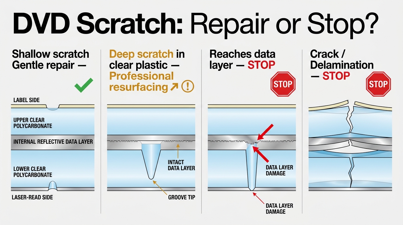

| What you see | What to try first | When to stop |
| Fingerprints, dust, oily smudges, light haze | Microfiber cloth with distilled water or isopropyl alcohol; wipe from center to Edge | Stop once playback returns; do not polish a clean disc unnecessarily |
| Fine surface scratches on the shiny side | Clean first; then use DVD-compatible polish as directed | Stop after one careful attempt if readability does not improve |
| Superficial label-side marks | Test the disc in another drive; do not polish the label side | Stop once the disc reads and save the readable content |
| Deep read-side grooves | Professional resurfacing if damage is limited to the clear plastic | Do not sand; stop if the disc is cracked or separating |
| Cracks, Edge separation, or visible layer deterioration | Do not polish or place the disc in a drive | Stop; resurfacing cannot repair structural or recording-layer damage |

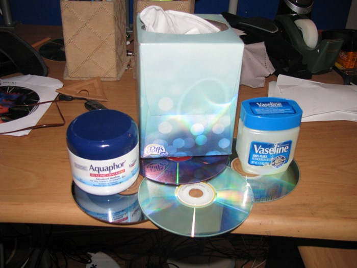

Option 2: Why Vaseline, wax, and banana residue are not repairs
Vaseline, wax, and banana residue leave a surface coating rather than removing a scratch, and they do not rebuild recorded data. Optical reading does not physically contact the laser-read area, so leaving residue on the disc introduces contamination without repairing the damaged plastic.
- Clean the disc first to remove dust or fingerprints.
- Do not apply Vaseline, wax, or food residue to the disc.
- If a coating has already been applied, remove it carefully with a clean microfiber cloth.
- Make sure the disc is clean and completely dry before placing it in a drive.
- Test the disc once and back up the content if it reads.

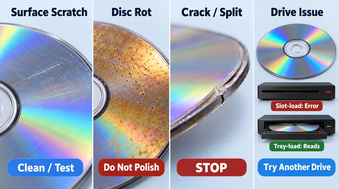

When It Is Not Just a Scratch: Disc Rot, Deep Damage, and Read Errors
On a single-sided DVD, a superficial label-side mark does not by itself indicate recording-layer damage; cracks, Edge separation, and visible layer deterioration are different failure signs.
Disc rot is different from a scratch
Disc rot is a failure of the disc's data or reflective layer, often caused by oxidation, material breakdown, adhesive failure, or layer separation. It is not a surface scratch, so toothpaste, wax, polishing compound, and repair kits cannot rebuild the damaged data layer.
Common signs of DVD disc rot include:
- Bronze, brown, cloudy, or uneven discoloration
- Tiny pinholes when the disc is held up to light
- Visible material loss or flaking on the label side; a superficial mark alone does not indicate disc rot
- The same read failure across several players or drives
If you suspect disc rot, stop polishing. If there is no cracking, warping, or separation, try to read the DVD gently in another drive and copy whatever still reads as soon as possible.

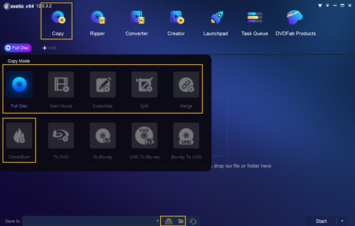

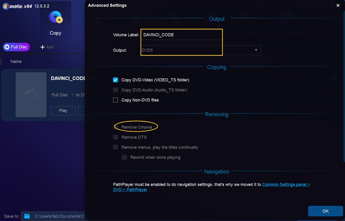

Copy DVD to ISO/Folder: DVDFab DVD Copy
The first method is to create an ISO or VIDEO_TS folder from a readable DVD, preserving disc structure such as menus and subtitles according to the selected copy mode. Copying requires readable source data, and successful playback does not establish that every sector needed for a complete backup is readable. The free trial of DVDFab DVD Copy lets you check source recognition and whether the copy task reaches completion.

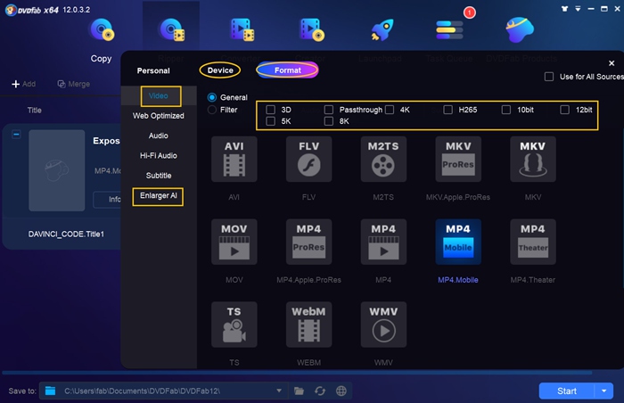

Rip DVDs to Digital Formats: DVDFab DVD Ripper
If you want a video file instead of an ISO or folder, DVDFab DVD Ripper can convert a protected DVD to formats such as MP4 or MKV for direct file playback. Confirm that the task reaches completion, then play the file through the formerly failing passage and the ending before relying on it.
